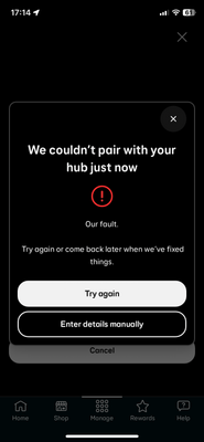

I have recently signed up to EE Broadband.   My broadband is working fine, however the APP WiFi controls feature and the Wifi enhancer are not available on the app or via the website.   An error message appears and states it is a problem with EE.  I  have spoken with the technical team at EE on two occasions and they have recommended i reinstall the APP and restart the router.  I have now done this many times and the APP features are still not working.   This is very very VERY frustrating!    I am going in circles with the EE technical team and it is not clear how or if this will be resolved.  EE is not living up to expectations.  If there is an issue, i would prefer EE acknowledge the fault and advise when it will be fixed rather than directing me to do the same thing over and over again (i.e reinstall the app).   Can anybody help?   Is this new feature just a myth?

I also told them that the latest app “pair with hub” button doesn’t work, click it and nothing happens, they weren’t even aware of this!

Mine is EE smart hub plus as well. Tried around 30 times but still not working.  You have mentioned that we need to update  a software first. Do you know how I can update it before I try again? Thanks.

First keep on scanning the qr code, 9 out of 10 times it will fail to connect, click “done it” each time in the setup, I think it’s a total of 3 times, then it will say “check for updates” click okay, this takes about 20-30mins.
don’t loose hope it it doesn’t work, just expect that experience from EE, it will fail again and again, but eventually after about 20+ tries it will eventually work.

I have tried 10 times and in all 10 times it does not go beyond this screenshot.  Thanks for sharing your screenshots.
