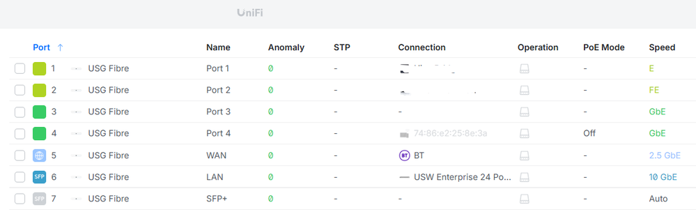

Yep, positive! I am happy with my network... ONT/WAN connected at 2.5gbps and uplink to my core switch is up at 10gbps.
I will continue to investigate, hopefully just a blip.

Edit:- sure looks fine Unifi wise, you can only test your connection out and see what / where you trust it all to be. Looks like you have a pretty good handle on it though.👍
