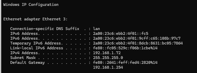

Interestingly if I run IPconfig I see the following:
NB Router is configured to use Quad9 for DNS
