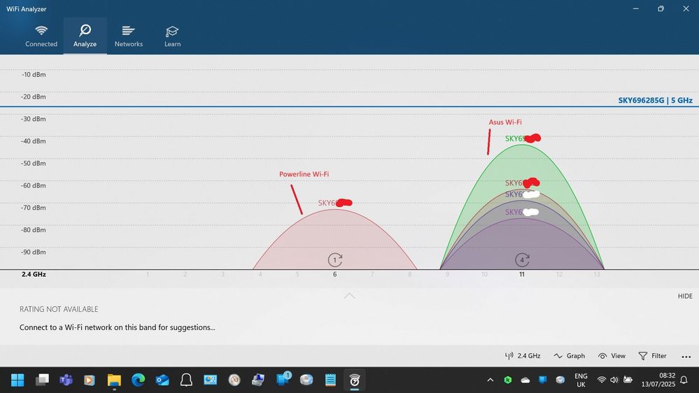

@tnj Nothing wrong in having it that way then, CH13 is not a UK supported as that is the END off it, only US goes up to 16!
2.4Ghz setup2.4Ghz setup5Ghz setup5Ghz setup
TraderTravel
Established Contributor
The issue is that by selecting 11, you are in fact using bands 9-13. I have a few devices that can't use 13, so the use of channel 11 needs to be avoided. Hopefully this makes sense. A lot of older (and still shipping) IOT devices like lights and smart switches etc unfortunately have this issue in the quest to be 'globally compatible'.
