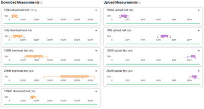

not sure what if anything has changed but the issue appears to have magically disappeared for me, can anyone else please confirm if you are still getting timeouts, preferably using https://speed.cloudflare.com to pull stats?
edit: included screenshots of tests, have ran 5 similar tests to this within the last hour.
edit 2: never mind, its back to being inconsistent, sometimes getting stuck midway through a test and dropping packets galore. had hope for a second there 😛
