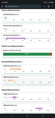

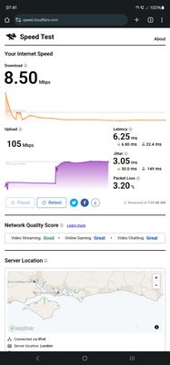

I have EE's Full Fibre package and hadn't had any problems in about 10 months of service. However, for the last 24 hours (maybe longer) I am experiencing extremely slow speeds to certain sites. For example, loading a discord channel may take 4 minutes to load. The emoji panel makes dozens of requests in a short frequency and also fails to load correctly.
I do not experience this issue while connected to a VPN.
I experienced something similar on Friday using 5G (also with discord) but put that down to signal issues.
Discord is not the only site that is affected. I host some public services on a remote server (Germany) and use CloudFlare proxy in front of these. Speed issues are also apparent for these, which again, do not reproduce when using a VPN. In fact, if I edit /etc/hosts to bypass CloudFlare's proxy, everything loads instantly. Note, that Discord also uses CloudFlare.
While it's possible the issue is my end, e.g. my router, Friday's issue while on mobile has me wondering if there's some issue between EE and CloudFlare? There appears to be severe throttling where the first several requests are fine and any subsequent requests are exponentially slower to send/receive.
I've also encountered similar while pulling images from docker hub and github container registry (although I do not believe either use CloudFlare).
