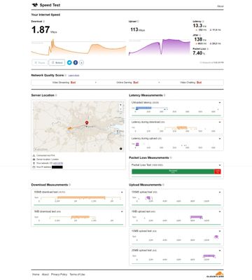

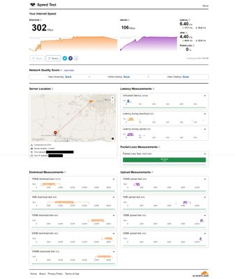

22-08-2023 07:02 PM - edited 22-08-2023 07:07 PM
I spoke with a customer support agent who while sympathetic was unable to help as this is so far an isolated incident and hopefully may resolve itself given some time.
In the meantime, it may be useful if those of use affected can provide some additional diagnostics. The tables in my previous post were sampled from the CSV output of Cloudflare's Speed Tool. You can generate results using https://speed.cloudflare.com/. Here are a couple of screenshots comparing a direct connection and one using a VPN:
Cloudflare Speed Test Direct Connection:
Cloudflare Speed Test VPN Connection:
Additionally, here are mtr results while using a direct connection:
MTR Direct Connection:
**redacted** (172.23.223.117) -> discord.com (162.159.137.232) 2023-08-22T18:49:36+0100 Keys: Help Display mode Restart statistics Order of fields quit Packets Pings Host Loss% Snt Last Avg Best Wrst StDev 1. **redacted** 0.0% 52 0.2 0.2 0.2 0.7 0.1 2. **redacted** 0.0% 52 6.2 3.3 1.1 11.9 2.0 3. 172.16.11.38 0.0% 52 5.8 5.0 2.8 14.5 2.3 4. (waiting for reply) 5. 213.121.98.128 0.0% 52 5.3 6.3 3.5 37.6 5.7 6. 87.237.20.130 0.0% 51 5.6 5.9 3.7 21.1 2.8 7. 87.237.21.10 5.9% 51 7.1 8.7 4.6 32.1 5.7 8. 172.71.176.4 3.9% 51 81.9 11.3 4.9 81.9 14.5 9. 162.159.137.232 2.0% 51 5.7 5.9 4.2 11.1 1.6
