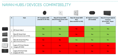

@Idle001, @Former_bt_user : The EE Smart WiFi Plus extenders are not compatible with the BT SH2. See:

@Former_bt_user : The EE Home app is intended only for the white EE Smart Router which you don't have. The EE app should be used with EE SH+ which you don't have either.

I have tried the EE wi fi boosters with BT hub 2. They definitely do NOT work!
I bought BT complete wi fi disc on eBay. This works well!
