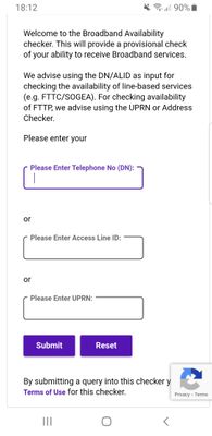

@Ceedee1   ok, are you able to post the results from the DSL checker - ideally use your phone number, if not your address but then we would also need to see your router stats.https://www.broadbandchecker.btwholesale.com/#/ADSL
I don't have a landline and no idea how to access the other information the link asks for.

It doesn't ask for my address. It asks for my landline, which I don't have, an access ID line and a UPRN, both of which I have no idea what these are.

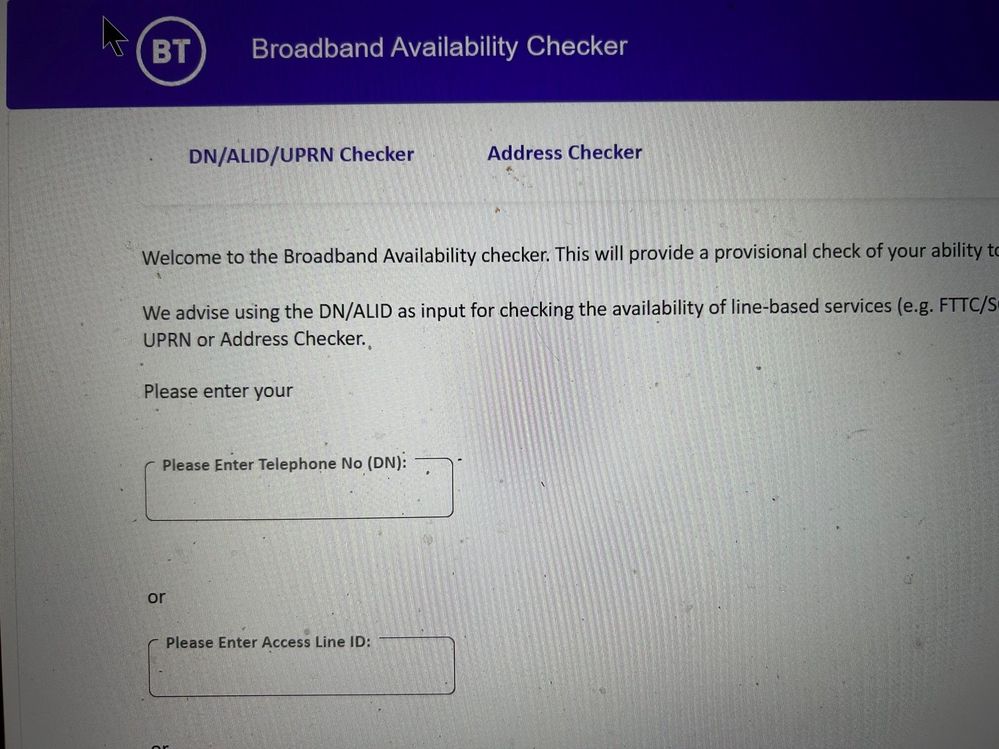

@Ceedee1  you appear to be using a mobile phone. You would need to change it to Desktop mode, or use a PC/Laptop. Or indeed you could ring the Help Desk as already suggested.
The pic below is what you should see.

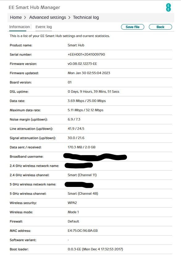

If you would like help with your BB speed or connection issues, please would you carry out the following steps for starters, which will enable us to diagnose the problem and advise you further. Do not restart your router to do these tests:
1. Post your full router stats:
  • For a BrightBox: login and go to Advanced Settings > System > DSL Status. Also post 'System Uptime' from top of System Log page.
  • For a SmartHub: login and go to Advanced Settings > Technical Log > Information. Obscure your names & any numbers in the BB Username & also the SSIDs.
  • For other routers: login to it according to the label on it as the admin user & navigate looking for its router/connection statistics.
Full router stats are key to any speed & connection issues.

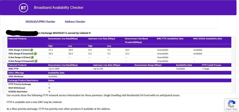

2. What does BT Wholesale Broadband Availability Checker estimate for your phone number? Post just the whole table and the line above it, blanking out your phone number. If it doesn't recognise your phone number or you don't have one, use the Address Checker, not the Postcode Checker.
