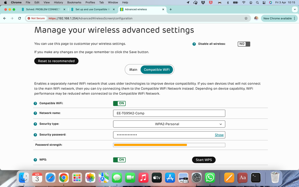

I too ran into this issue and couldn't see how the 10/5 sec routine would fix a password issue as it looked like I was getting in momentarily but then couldn't proceed to get the Blink server connected, so after some research, there is one essential underlying consideration you need to factor into your Blink installation, namely aligning the security requirements of the Sync 2 module with the new EE router. By default, the EE router uses WPA3 whilst the current (up to current releases) Sync 2 module can only use WPA2. Therefore you need to log into your admin profile on the router and enable the compatible WIFI feature. This is a relatively easy task and can be performed from your laptop/tablet either hard wired to the router or across the wifi. See here...
https://ee.co.uk/help/broadband/manage-use/how-to-set-up-compatible-wifi
Once you have enabled this feature, restart your blink Sync 2 installation and select this compatible network, probably named something like 'EE-TG95K2-Comp' or similar. Remember to use the password that you set up for the compatible network.
Tip: Screenshot as you go along in case you have accidentally changed something that you didn't intend to change. Be patient with the screen refreshes and when you have saved the settings, make sure compatibility wifi mode is running when you have saved and backed out, otherwise pop back in and turn it on again.
I've attached a screen shot of this config.
