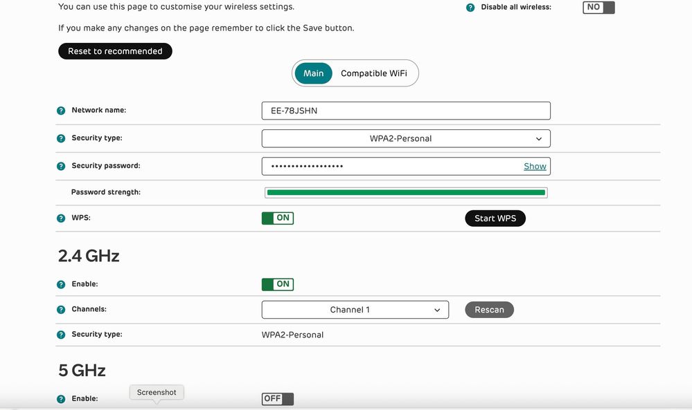

This is my hub page

What's the Compatible WiFi page look like?
It just shows compatible WI-Fi as "off"
what happens if I move it to "on"?
I don't want to cause a problem!

No problem! You can always switch it OFF again.

@BarryH2 You EE Router also looks all messed up so you are aware if anything else is going on with you wireless wifi!
How do you mean "all messed up"? It's on the original settings and I don't have any other issues that I am aware of
