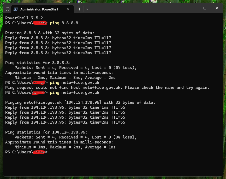

I've just had the router fall over a moment ago and this is a great example of the behaviour:
Exactly the symptoms seen in @ryajohnst's script output, i.e: -
  • Ping/ICMP traffic is successful to either the hub itself or an external IP address (although there's evidence to suggest that the response times are a little slower than expected)
  • DNS resolution using either the hub IP or direct to an external server fails. Likewise, trying to ping a host name will fail because the initial DNS lookup never completes
  • Evidence that the 'lock up' isn't specific to DNS traffic because there's a report that it was not possible to connect to an external SSH server via its IP address during the failure window
Update from me: I've had the aforementioned script running all afternoon across two machines. This time with the Guest WiFi feature disabled just in case it was having any beneficial bearing on things. Same results as before - I'm not seeing any DNS failures and it's only the Wi-Fi connection that shows (expected?) ping response variance 🤔
