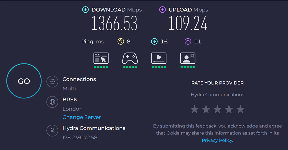

Hello Buddy,  the issues that customers are experiencing with DNS and slow webpage loading or freezing has anyone tried to use VPN,  I have tried connecting my Surfshark vpn seems to work ok I even rebooted my PC I connect to my VPN first then try numerous web pages all seems ok no freezing or DNS issues and by passing any restriction from EE router. Using the Wire guard Protocol and the speed is ok to speedtest using vpn Screenshot 2025-08-14 141855.png ,  this will do for now connecting this way  until they bring out the solution to fix the ongoing issues with firmware, it worked for me I'm not saying this will work for everybody.

speed test while connected to vpn

Buddy its working great I have had  no issues, speed is good no freezing or dns issues using surfshark vpn wireguard protocol
I even rebooted my pc with out vpn pages were slow to load freeze
then reconnected vpn works great
