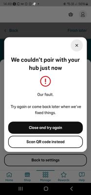

I contacted EE by phone and they told me to install the EE app on my phone but when I tried to pair the hub with the app you get a CONSTANT SPINNING CIRCLE which just goes round forever and it doesn't pair at all. They decided to send me the EE Smart Hub a week later and this did the same, despite factory reseting the router, uninstalling the app numerous times, installing the app on various tablets and phones I have access too.

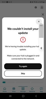

3) I launched the EE app and was greeted with this and started the update at 11.19am:
4) I waited a while so the router could update note that I was on mobile Internet so EE were using my account details to send the router updated firmware.
5) Now this is the key thing to notice the screen stayed the same and I didn't want to close the app however noticed the green bar at the bottom as it progresses slowly across the end is rounded that's when you know it's actually finished however I waited until 12.47pm..  
6) I noticed the green bar was rounded at both ends so it must of completed the update however the app simply required me to press X on the top right corner and suddenly it went from step 1 to step 3 complete at 12.47pm! 

Happening to me too. Came from BT. Months of not being able to sort parental controls. Cant connect app to router, either fails completely or says it need to update hub which then fails. Used multiple devices, app updated. Uninstalled, reinstalled, cache and cookies cleared etc etc
