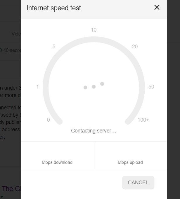

Hi Thanks for your response,
Unfortunately the bright box gave up on me ages ago so have been using a Netgear without any issues until my request to change to another provider,
Before the order was placed i was getting download speeds at 38mb and upload speed of 10mb. As soon as the order went in my speed dropped to no more than 12mb download and 6mb upload.
I maybe wrong but that is a dramatic drop in performance.
As well as that I get constant DNS errors, Example is to change a setting on my Alexa I have to disconnect from the wifi on my phone and then connect to it via the mobile network into the house via the internet to my network.
Other websites will not load ether while on my broadband connection but load perfectly via my mobile data on the same device.
I have none of the above issues until the provider change was requested, call me paranoid but this is a very strange coincidence to me.

Yes and as i said in my last message the speed test is 12 down and 6 up, currently as we talk now i'm unable to resolve DNS issues to connect as per screen shot, infact the only site i can currently connect to is this oneScreenHunter_53 Apr. 12 13.03.jpg
