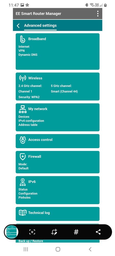

Please can you post the Advanced / Wireless Settings page of the router?
This is all I have got I know he put it into mode 3 and disabled the smart channel as all this does is change frequency

Sorry, not that page, but 1 below. Click on the Wireless tile.
Anyway as I expected he's changed Wireless Mode from 1 to 3. This could mean that some of your more powerful wireless devices (802.11 n & ac) will not achieve their full potential.
