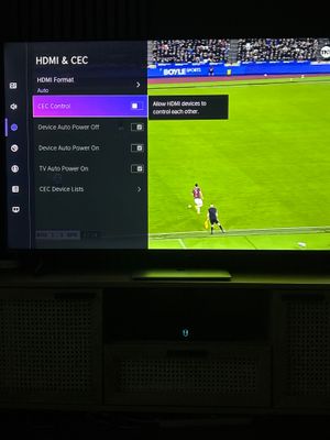

This is the current setting on the HDMI & CEC option. Even if it were to be turned on, why would that mean it should be turning on automatically? 3 of the last 4 mornings either both or one has been on.

I recommend turning CEC on.  If the EE TV remote then controls the TV then great. If not, then try resetting it:
