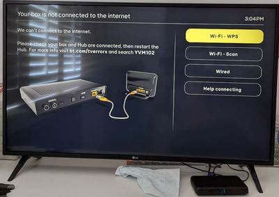

I’ve been on the new EE TV for just over a month now after some teething issues with the Apple TV box. I’ve been having trouble with frequent connection drops and tv channels not loading on the EE TV mini box I have in my second bedroom. When this happens I’m forced to unplug and turn on the box to get it going again.
I have the smart hub plus downstairs in the living room and a smart WiFi plus mesh unit upstairs, so there should be no issues with WiFi coverage. However whenever I check, on the TV mini box it complains about poor WiFi strength despite every other device in the same room having no issues at all.
Please advise? As these issues are happening on a daily basis.

  • Also aside from the IPC6023 error the box seems to periodically lose connection and be unable to see any WiFi network at all including mine unless unplugging from mains and plugging in again. Scanning for WiFi networks brings up zero matches until the device is restarted.
At present I'm needing to restart the mini TV box at least once a day.
