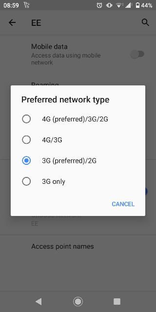

I think I get it now. My simple brain figured that if I switch off data that would result in switching off 4G (or not activating it), since it was only used for data. I suppose I need to change a different setting. Would this be sufficient to turn off 4G?
I'm fine with losing the advantages that come with 4G I think, if this causes pain I can always turn it on again. I just want to see if it resolves the problem with calls not getting through. I set the phone to the option shown above, turned on data and that showed EDGE, which I understand is something between 2G and 3G. So it looks like it had the desired effect? Once I get hold of another phone I'll test this set-up vs the original setting.

EDGE is a 2G technology to enhance data rates, EE's 3G network was switched off well over a year ago, so 3G/2G mode effectively means 2G-only.
