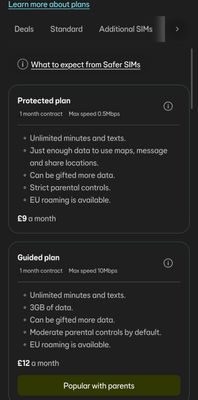

If this was a data speeds concern, the £9 Safer SIM Protected Plan has maximum speeds of 0.5 Mbps whereas a standard PAYG SIM has a 25 Mbps speed cap which may explain your issue.
It is an intentionally 'locked down' plan to ensure only the most essential data usage is allowed such as iMessage/RCS or Maps, but not suitable for anything more intensive than that. Perhaps another plan may have suited your needs better than this.
