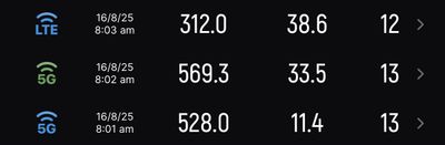

Same for me. Im in SE London in an area covered by SA and in particular the upload speeds are shockingly bad compared to NSA and 4G.
Speedtests consistently show SA uploads way below 4G and NSA 5G and usually the upload is really ragged giving wild fluctuations where the others are consistent.
Top is 4G (usually actually get more like 400 Mbps) then NSA then SA - with SA routinely lowest upload, worst ping.
i upload quite a lot from my phone and have been really not impressed so far, usually turning to 4G when doing a lot of uploading.
There are rules of physics at play a little - here I’m often on band 3 for 4G but band n78 for 5G SA. Band 3 is lower frequency so will travel further and likely be more consistent, N78 higher and need to be nearer the mast for better, reliable speeds.
Kind of answering my own complaint here - until we have a lot more (possibly lower power) cells particularly for higher frequencies the experience of 5G SA is likely to be patchy as it’s always at the higher bands which = higher speed but lower range (tied with phones which like the networks favour the download portion).
