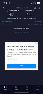

wcavanagh
Valued Contributor
Valued Contributor
Well look at this
Pic needs approval by Mods in order to show up. 😉
