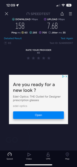

Hi Everyone,
Done some testing today, as it is raining loads, I just did some port testing.
Found something very weird.  I have two 2x2 antennas pointing at different towers, for testing.
So using just one the best speed I could get was 102Mb using ports, 1 and 4  (assuming port 1 is by switch) as per photo.
I tired all other combinations, all worked but had between 60 - 80 Mb.
So then I connected the 2nd 2x2 antenna to ports 2 and 3 as per photo below...
Now I am seeing 158Mb the best I have seen from this device.  Now when it stops raining I will point both antenna's at the same tower, as tower 1 gives faster speeds, I wonder if I will get closer to the 200Mb I see on the iPhone?
Excuse the hot melt glue, I used this to secure the weak TS9 connectors, they are rock solid now, after seeing peoples issues 🙂
