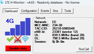

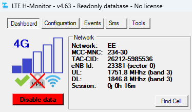

I have found a program called LTE H-monitor which is how I've been able to well when the router switches between bands.

Ext Antenna connected

Ext antenna disconnected (router only)
