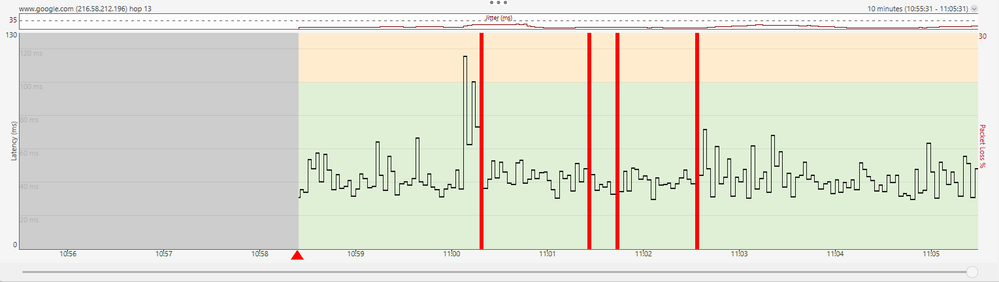

15-06-2023 11:11 AM
Heres another example of the problem just using google.com via an known static ipv4 address
Each red line is a route change occuring, the destination remains the same, but the gateway being used changes
