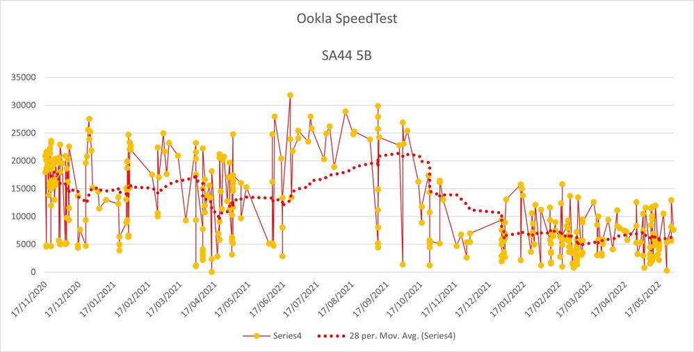

The chart shows the random test results over the last year or so and a trend line to help smooth the data out.

Line of sight isn't absolutely the be-all, end-all of functionality, signals are bent, refracted and reflected and so can be picked up from around buildings and behind hills. We are in that situation as the target mast is indeed behind a hill. To be line of sight we'd need a dish up at at least 25m, 40m even. The step change was that exactly, a step change and not a gradual degradation. Vegetation would have been gradual. That, and the fact it happened at the end of October/November would suggest vegetation would have been dormant and/or loosing leaves at a rate.
That being said I wondered if it wasn't trees but a new shed or barn? It would need to be right on the brow to have an effect. Not the usual place for a farm building owing to the winter winds. However, the flaw in that theory is that it's intermittently very bad. It's overall worse than it was (see graph) but at times is still around 12Mbs which is OK (it's all relative eh?)
