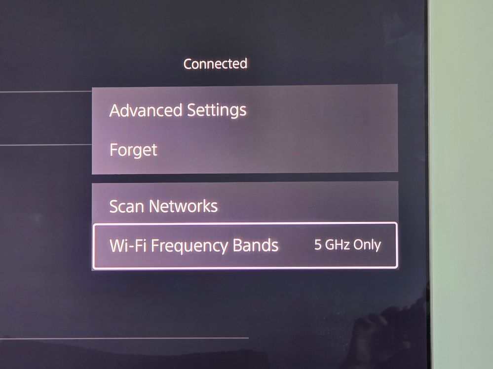

I have posted before about this but on the non pro PS5 you need to go into the network settings and change the network to 5Ghz, this helps massively but is dependent on your console location to your modem.

OK, so I stopped COD, switched back to the "new" Wifi SSID, and fixed the band to 5Ghz.  PSN logged in fine, with a decent download rate.  Then tried to go into a new COD instance - identical failure as to before.  I then reset to Legacy WIFI, and got straight back in with both.
