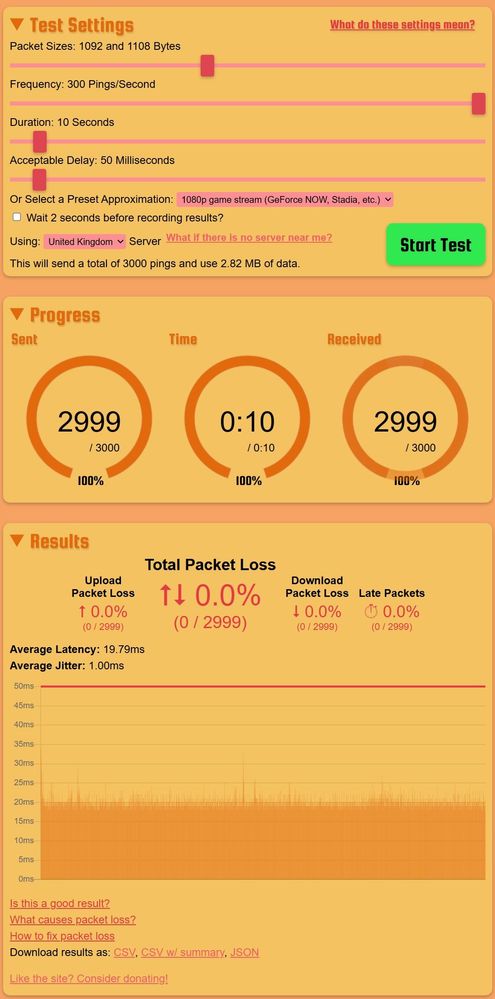

23-05-2026 03:04 PM
@sadw1nd Looks like you have an upload problem, try the link below also. And the settings....
Packet Loss Test – Test Your Connection Quality

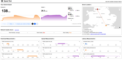

24-05-2026 01:22 PM - edited 24-05-2026 01:23 PM
The cloudflare speed test seems to give slightly worse results than other tests like fast.com - download latencies around 30ms even though the unloaded measurement from other speed checkers can be closer to 4ms
But upload latency can be around 100ms rather than the 300+ youre seeing so - as mentioned above - that seems to be where the issue is - which might be a PC or fibre issue
Its tricky trying to figure out how uploads on full fibre technically work from the ONT given everyone shares the same fibre with neighbours - on older copper you'd have your own connection - so its possible the issue relates to uploading
