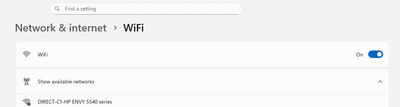

What version(s) of Surface to you have eg Surface Pro 9.
On a Surface go to settings -> Network and WiFi -> WiFi
Check WiFi is switched on expand show available networks, do you see your SSID listed, If you have not changed it, it will show up as EE-??? same as on the slide out tab that comes with the router.

its a surface pro 7
the network shows up correctly with the correct name shows up, the password is accepted and it connect and states no internet is available
it is correctly connecting to the router but does not allow an internet connection

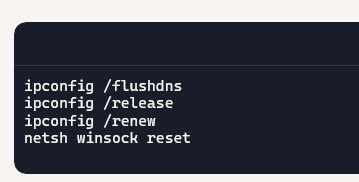

@fuzzyduck121  Looks like a DNS issue.
Open the Command Prompt type CMD in windows search -> Select run as Administrator
Type the following commands and press enter key after each, or copy /  paste them into CMD window
ipconfig /flushdns
ipconfig /release
ipconfig /renew
netsh winsock reset
Restart your Surface

much appreciated I will try this
This didn’t work
Exact same as before it connects to WiFi with full signal and shows in the bottom corner as full WiFi but says no internet connection available
