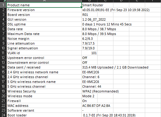

20-01-2023 02:12 PM
Good, so far as it goes.

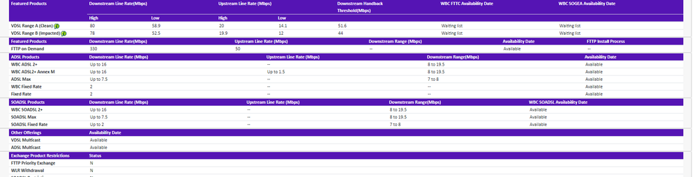

Would you mind posting your router stats as of now? The previous set were running half-speed.

20-01-2023 02:53 PM - edited 20-01-2023 02:59 PM
Not a great improvement. At bottom end of expected range.
What are all EE's estimated speeds which you'll find in your MyEE for BB under Your broadband speed?
