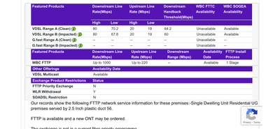

 That’s the table thing from the BT checker.

Full Fibre (WBC FTTP) is already available there.
