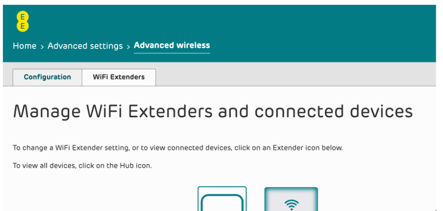

Hello,
In case you fell into the same trap as me. The extender doesn't show up in the my network page. That shows devices connected to the extender and if none are connected shows 0 even if the extender is connected. The WIFI extenders connected can be found in the page shown below.
@Redacted It's more about the stupid flashing orange light once the sucker is switched off for the position move and back on again, then it just does not want to re-connect back up to the Hub and go Aqua!
