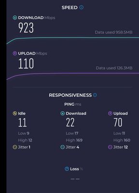

@bobpullenin the evening yes over Wi-Fi and Ethernet. Both disc’s are connected to the smart hub over Wi-Fi backhaul. I understand once more ppl use the internet in the evening the bandwidth is shared between us all etc. With BT on their equipment we didn’t have these problems as much. The kids moaned from time to time but it’s been almost every single night since joining EE they are complaining and nothing has changed in our setup apart from the EE equipment.

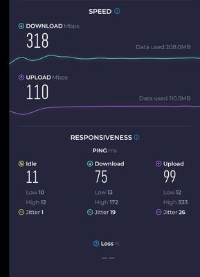

Speedtest NOW as I’m the only one home currently over Wi-Fi on my iPhone 15 pro max
Last night over Wi-Fi on the same device
Again I understand that the bandwidth is shared out over multiple users on the home network. But the main issues are my boys PS5 and gaming PC upstairs. They complain so much about lagging and poor Wi-Fi when gaming. Like I said we had the BT discs and Home Hub 2 and it was never this bad on Wi-Fi. I thought coming over to EE on Wi-Fi 6 would be better but we are having nothing but issues. I use Ethernet downstairs to my gaming PC and even I was getting packet loss and issues last night when gaming which I’ve never seen before since being on full fibre since January. Hopefully I’ve commented something useful if you need anymore information I will try my best to screenshot what I can etc.

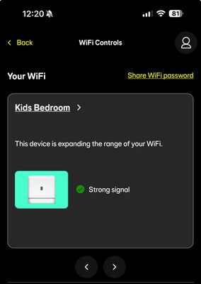

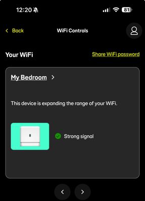

PS forgot to add that I looked in the Home Hub UI and it says to use the app for the Wi-Fi extenders doesn’t give any information about them at all.

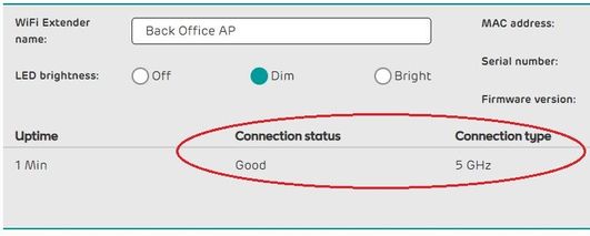

@TuckerUK wrote:
If you navigate to the Advanced Wi-Fi settings in the Hub Manager/GUI, and highlight each extender, then it should tell you if the connection is over 2.4GHz or 5GHz backhaul. You need it on 5GHz ideally.
This would be helpful to see during a time you're having Wi-Fi problems upstairs.
It's the info below that's of interest for each extender: -

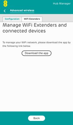

@bobpullen
I was logged out on here and couldn’t see your image you posted. Logged in and now I see it I can confirm that I don’t see that page in the Hub UI that you’ve posted.

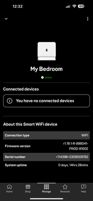

If you tap the name of the extender in the app then it will probably show you similar info. I think to view the page in a web browser you need to be using a desktop machine/or desktop mode on a mobile device.
TuckerUK
Established Contributor
  That’s all the information you get with the app
