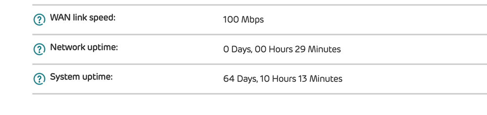

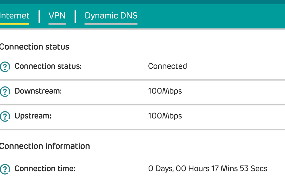

I am currently signed up with EE for Fibre Max 900, with 900down and 100up. However on the router manager the WLAN Link speed is showing as 100Mbps, and the downstream and upstream rates are both saying 100Mbps instead of 900/100. Is there anything I can do to change this or is it a case of calling in?
I have checked my account and it is still showing Max 900, suggesting that I haven't been downgraded from EE's end??

@Owstap On your earlier pic it shows your WAN link has been up for 29mins, but the system up for 64 days. A quick power off to the modem and Openreach ONT may well get you back to full speed.
But also check and maybe try another cable between the router and ONT.
Let is know how it goes.

That's not a Wireless LAN speed; that's an Ethernet speed.
What's the rest of that page say? Obscure your names & any numbers in the BB Username.

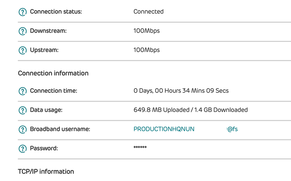

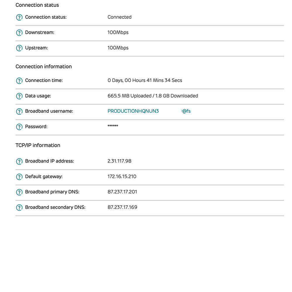

Sorry I linked the wrong photo. I've attached the bit that mentions WLAN, and the other page in full!
13-09-2022 12:08 AM - edited 13-09-2022 12:10 AM
& still the rest of that page please?
WAN (Wide Area Network) is not the same as WLAN (Wireless Local Area Network).

OK! So, on which page do you see the WAN Link Speed, that you showed above the Home > Advanced Settings > BB > Internet page? Your pages are confusing me.
13-09-2022 07:21 AM
so the WAN link speed is showing under the Status Tab. And the other picture, is where you mentioned. Under advanced settings > BB > Internet

There is omething wrong somewhere. With FTTP the WAN speed should show as 1000Mb up & down as it is the link speed between ONT & Hub.
As suggested try chanking the ethernet patch cable between ONT and router.
