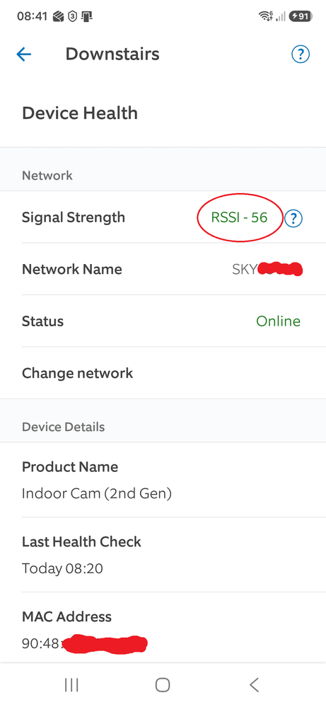

@Pervs2 As you say you also have Ring Camera or Cameras have added the capture to one off mine, did the indoor one and it is direct connected on an Asus AP working through the Ai Mesh wired backhaul for that node, you will see it when approved for general viewing.
Ring Camera signal strength but to an Asus AP.Ring Camera signal strength but to an Asus AP.

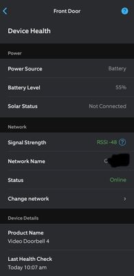

currently my ring door bell is working and connected. Here is the strength of mine. (Photo should show when approved) My doorbell is right next to the router so I expect it to have a good signal. I have a ring chime pro upstairs and I use this to connect one of my cameras as it helps to boost its signal.

@Pervs2 Yes it will if it's folding back because off a clash with another 2.4Ghz signal band, and look closely at your Ring Chime Pro as soon as you introduce it, the ring doorbell plus the ring camera's will favour that instead off the Hub connection that is the whole issue when using the Pro version off the chime. Will look at your picture when cleared RSSI is better down as a lower negative number, when i remove the TP-Link on mine it jumps up to -78 ish for the nearest Asus node, still works but the response is way different. As soon as i put the Tp-Link back in the power socket 99% off the time i just have to reboot the doorbell so it latches onto it.

@Pervs2 RSSI is good value for your Front Doorbell, -48dbm is acceptable so you should get a good response from it.
