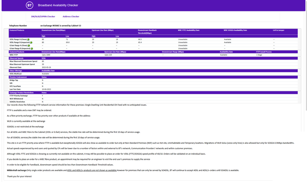

@Thunderfinger  given that the DSL Checker shows you are getting the max speeds to your router, and the tablet still works OK, it would seem the issue is with your new HP.
It maybe the WI-FI card is faulty, or does not like the combined Wi-Fi bands on the newer EE routers. Are you able to move it closer to the router and connect it via an ethernet cable to see if the speed improves?
