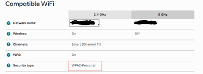

@Aitchtee I had a similar issue with my Octopus Mini Hub. Turns out that some of the newer 2.4Ghz channels that modern routers can access are not accessible by all devices that connect on 2.4Ghz.
What I had to do was switch on the Compatible WIFI on the router and set it to run on 2.4Ghz using WPA - Personal as the security and I was then able to connect to my Mini hub.
If you can connect to your security camera when you are away from home (As I can to mine) this will work for you, otherwise you will need a device on the same network as your camera.

Thanks for that.
As it happens I have done this already as you describe but still having problems. I don't have the mini-hub.
