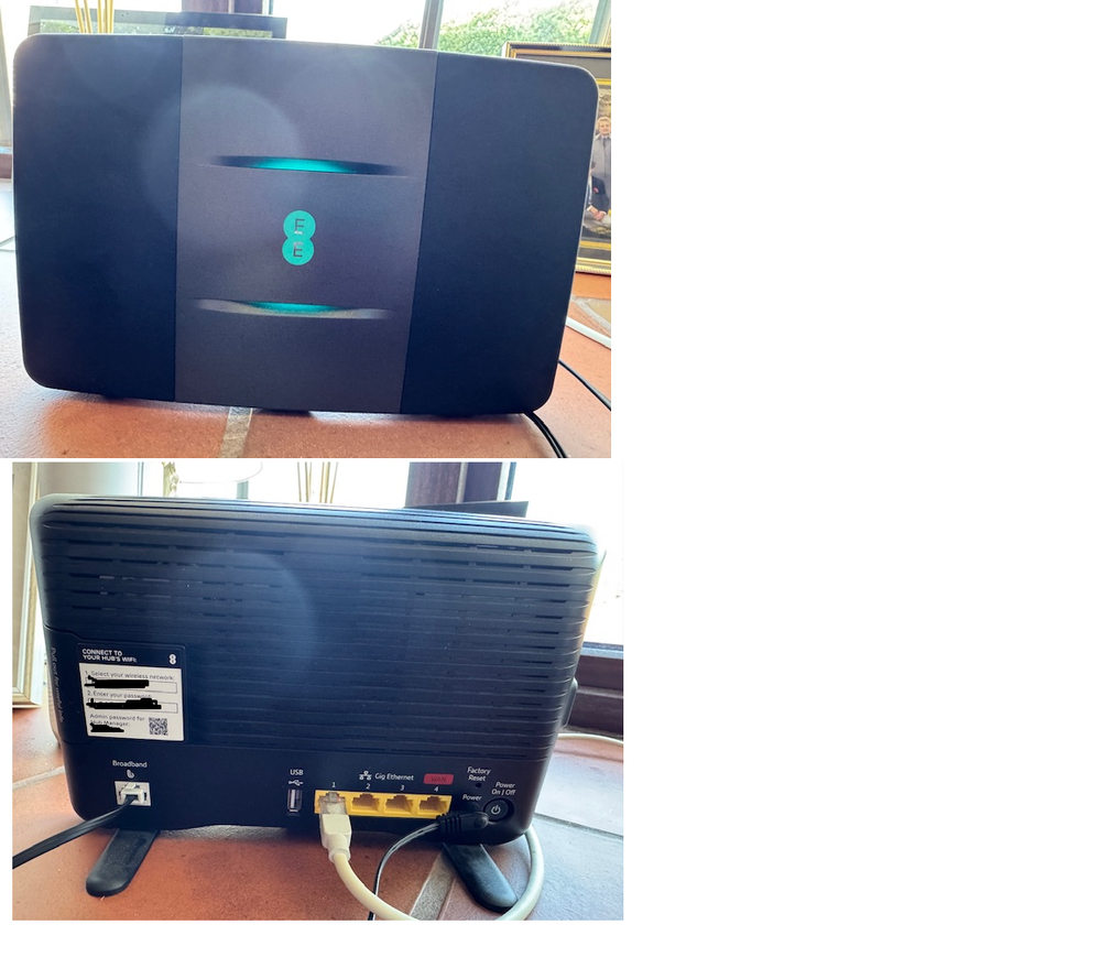

Hope this helps re the router.

Yes, that's the original (not current) EE Smart Hub. Unless it's faulty there'll be no point in replacing it. You are probably on ADSL BB.

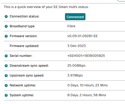

Afraid I got an error 404 when clicking on the speed test results page.

Thanks! You are running right at the bottom end of your expected range of speeds 😞 . I can't see a replacement router getting away from that.
Locate the hidden test socket that is revealed when you remove the bottom half of the split faceplate (2 screws or press tabs) of your master socket. Only do this if you have a split faceplate. Do you have any extension sockets in the home even if unused? Are there any wires connected to back of faceplate of master socket?
Only if you have an active landline, try the BT Quiet Line Test (QLT), dial 17070 Opt 2, preferably with a corded phone, in the test socket with the router disconnected. If there is any noise, report it to your landline provider as a voice fault (don't mention Broadband). Often sorting out voice faults will fix the Broadband as well.
Reboot the router & plug it into the test socket using a DSL dangly micro-filter. Post the full router stats & System Uptime when plugged into test socket.
Is the issue any better?

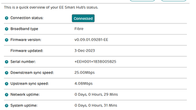

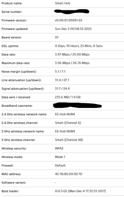

Hi, thanks for your response.
There are no extension sockets connected to the back of my 5c.  I've plugged a microfilter into the test socket and re-booted.  No change to speed but I'll monitor and see how I go with stability.

Thanks. Would you post the Advanced Settings > Technical Log > Information page from the test socket? It has more useful info.
