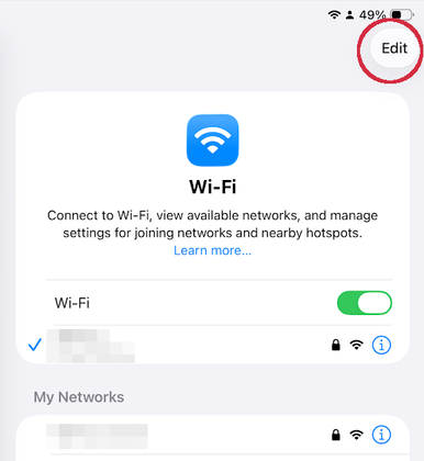

What were the exact steps you took to do this? IME, Apple devices can be very fussy/particular when it comes to 'properly' forgetting a network.
i.e. instead of tapping into the network and forgetting it from there, I've found better success with clearing from the keychain using the section underneath the (easy to overlook) 'Edit' button circled below (might have to wait for the image to be approved before you can see it): -
