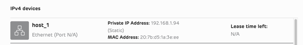

No I'm not on a business contract but it looks like it is static? - I've attached a photo
but I mean Source Connect worked with Virgin's port forwarding at someone else's house - as I say I think there must be something blocking it on this network, as I don't think it requires a static IP to run port forwarding?

No, that's just the private internal IP of your Ethernet'ed device on your LAN. It may be static or fixed on your LAN but is nowt to do with your public external IP that is used to access your LAN from outside & for Port Forwarding to work.
If you don't have a static public IP, as you don't, you need to use Dynamic DNS (DDNS) for Port Forwarding to work. The EE SH+ router you are using doesn't support DDNS. It is likely that the Virgin router at someone else's house did support DDNS & so port forwarding worked there.
BTW: Your image was rejected cuz it showed 1 of your MAC addys.
