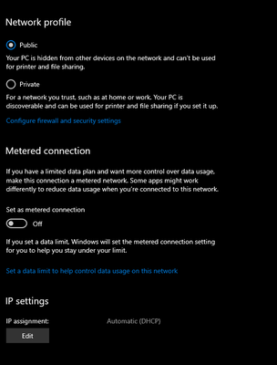

@LiamStevo wrote:
That will 100% affect port forwarding. The network connection needs setting to 'Private'. This is a fairly common issue when a router is swapped out, Windows 'sees' it as a new connection and 'helpfully' defaults the connection to 'Public'.
@LiamStevo Also remember to pull your IP back out off the DMZ once you have adjusted your Network profile.

I tried setting it to private but unfortunately that didn't fix it.

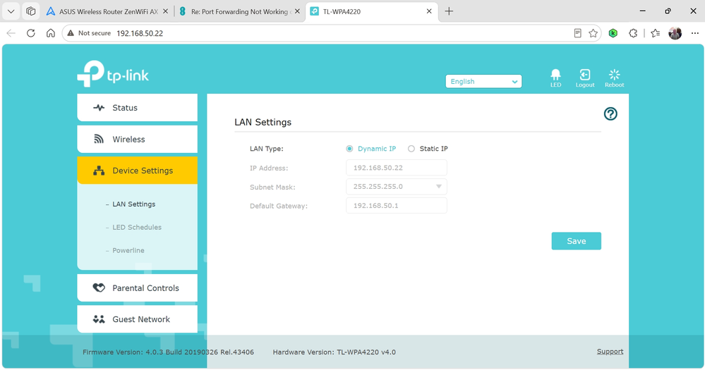

Once you know the IP of the Tp-Link you should be able to get to it through the web manager, my Tp's are 192.168.50.22 and 23 as i have two off them and the wired one only shows the single IP as 50.19, All the Ip's are set STATIC on in my case the Asus Hub, but it's the same way as doing it on the EE Hub....
Edit Inserted picture if it get's cleared.
Tp Lan settings assigned from the router  DHCP
