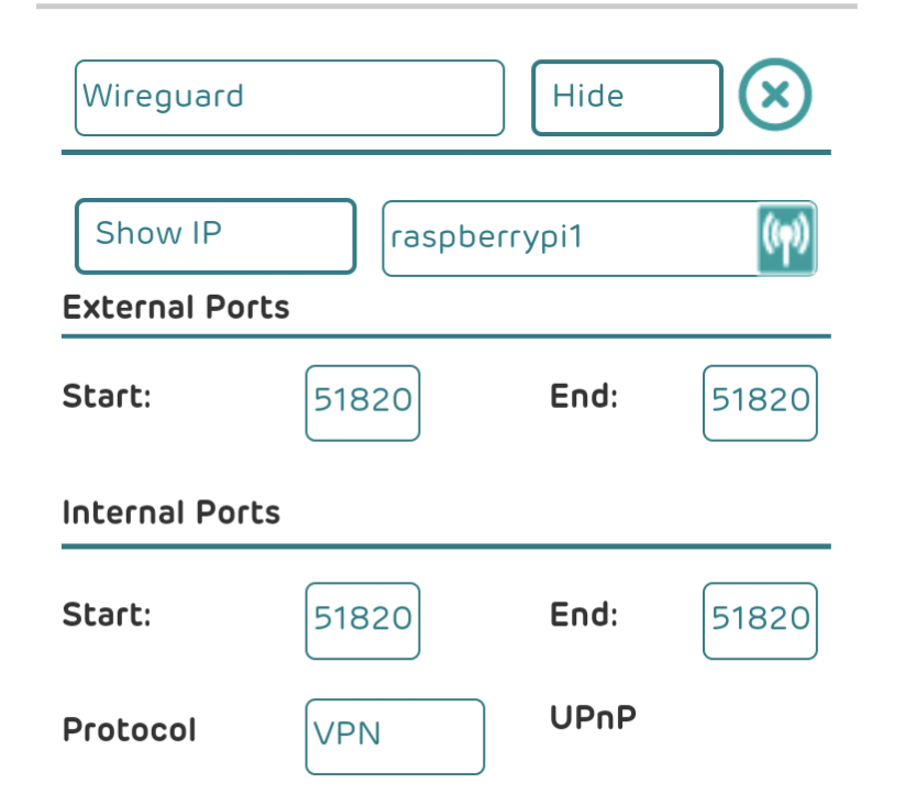

Hey all,
I'm looking to create a VPN and using PiVPN on my RPi was my choice.
Sets up well but when it comes to the port forwarding, it seems to run into issues.
Under Advanced > Firewall > Port Forwarding
The port I have is 12345
I've set this at both the Start and End ports as well as external and internal ports.
I've also tried setting it as a VPN and TCP/UCP protocols. But no joy, it just hangs. I feel it's the port forwarding but I can't test it either way.
Thanks in Advance

27-05-2022 01:43 PM
Which router do you have?
What does ShieldsUP! report the status of your ports when you use its All Service Ports & also your opened port with User-Specified Custom Port Probe ?

28-05-2022 07:03 PM
Hi, @XRaySpeX
I have an EE Smart hub but I do think it's on the "older" side
So I ran those test and got the below results:
```GRC Port Authority Report created on UTC: 2022-05-28 at 18:01:52
Results from scan of ports: 0-1055
1 Ports Open
1 Ports Closed
1054 Ports Stealth
1056 Ports Tested
The port found to be OPEN was: 80
The port found to be CLOSED was: 443
Other than what is listed above, all ports are STEALTH.
TruStealth: FAILED - NOT all tested ports were STEALTH,
- NO unsolicited packets were received,
- NO Ping reply (ICMP Echo) was received.

28-05-2022 07:08 PM - edited 28-05-2022 07:09 PM
OK & what about the User-Specified Custom Port Probe ?
What do you mean by an EE SH being on the "older" side?

28-05-2022 07:32 PM
```GRC Port Authority Report created on UTC: 2022-05-28 at 18:31:12
Results from probe of port: 51820
0 Ports Open
1 Ports Closed
0 Ports Stealth
1 Ports Tested
THE PORT tested was found to be: CLOSED.
I think I've had the router for nearly 4 or 5 years now.

28-05-2022 07:38 PM
That "CLOSED" usually means you have set up Port Forwarding correctly but the server on that port is not up & running.
The age of the router has nowt to do with your issue.

28-05-2022 09:15 PM
No, as I said the Port Forward has been set up correctly. It's the actual server program that is not running.

28-05-2022 10:10 PM
Ok cool, I'll revisit pivpn then!
Thanks for your help @XRaySpeX. at least I wasn't going mad!
