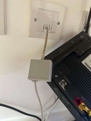

My home currently lacks internet connectivity, which is scheduled to be activated on the 16th. However, I wish to enquire in advance regarding the following setup: as illustrated, I intend to use a converter-like device (the white square in the diagram) to convert my bedroom's telephone socket into a dual port for both internet and telephone lines. The internet port will then connect to a WiFi router (the black section in the diagram), which will in turn link to my computer via an Ethernet cable.
My question is: if I set this up as described, will my PC be able to access the internet once the connection is activated on the 16th?
12-10-2025 10:40 PM
Yes, just connect your PC to the router either by Ethernet cable or by WiFi. No need messing about Ethernet ports in the walls.
Looks like you are getting a partial Fibre (FTTC) or ADSL connection.
