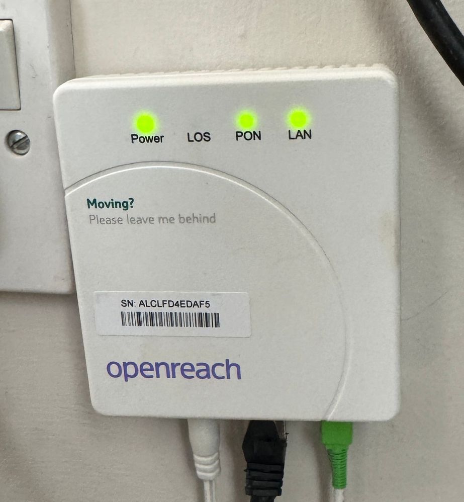

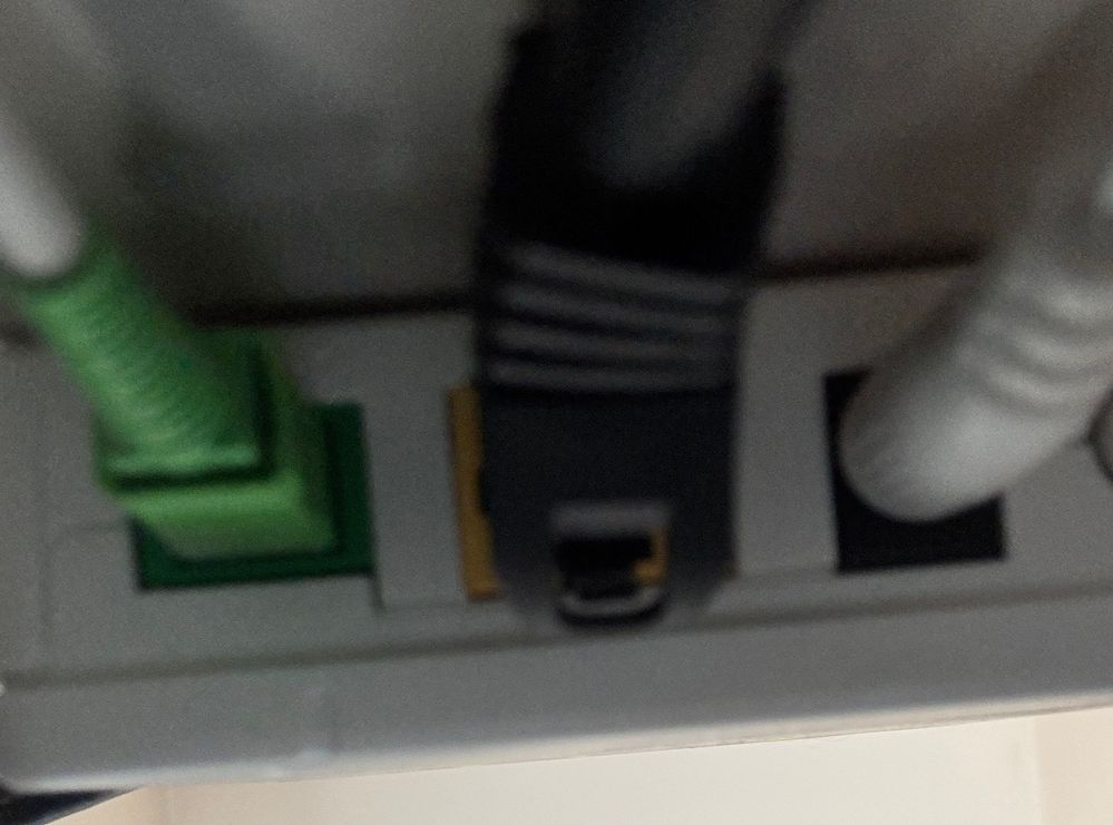

I didn't realise there were different types of ONT and assumed if I was being offered 1.6 Gbps it would be capable of that. Can you tell from the picture please?

From what I can see this is a Nokia ONT and if the connection is orange it should be 2.5G Model. I think this looks orange.....IMG_8808.JPG

Obviously if the WAN is limited to 1 Gig nothing else can run at more than 1 Gig. Then there's no LAN issue and the root cause is the limited speed WAN i.e. a 1 Gig ONT.
@paulmccarrison2   That does look like it is a 2.5Gb ONT, you can see a clearer pic in this thread.

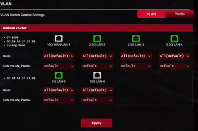

Which ports are you using on the router? From the specs:
1 x 10Gbps for WAN/LAN
1 x 2.5Gbps for WAN/LAN
1 x 10Gbps for LAN
3 x 2.5Gbps for LAN
1 x RJ45 10/100/1000Mbps for LAN
I would start with the ONT in the 2.5Gb WAN/LAN port, and your PC on one of the 2.5Gb LAN ports, and check the router has negotiated both at 2.5Gb.
I beleive someone had a similar issue which was down to using the wrong ports.

Hi I think I have everything connected correctly but no improvement in speed
