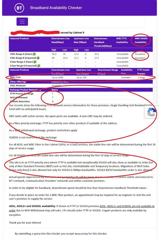

@rossdorf Since you have no real need for BB or speed, then lowest speed offer with DV included is what you want with the lowest priced option if EE is supplying that in the offer. Just watch out for the Landline cost's if not taking a DV Phone package with it all. In is free, out is quite costly.... Updated Pic attached when cleared you should be able to see, and what to look at with your Dad's home address.
Latest BTW for my address and already on a FF500 connection.Latest BTW for my address and already on a FF500 connection.
