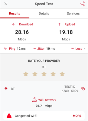

 this is a speed test just now, from the lounge.
@ReShine Pictures take time to be approved and checked before released for viewing, but in the meantime, have you been asked to Factory Reset that BT Smarthub2 Router or has anyone else done so recently with the visit's etc! Will look at the picture when cleared! Have a read at this linked post also working on with other OP!

Don't worry, the images were awaiting approval. I have now done so & they should appear soon.
@ReShine Have seen the speed test, take it that you did wireless w-fi speed test, and where is the Router in that same location? Network is all shared and if possible Ethernet connected is always more preferred!

The speed test was done in a room slightly away from the router & wireless. I'll do one next to router, but it will be wireless again.
