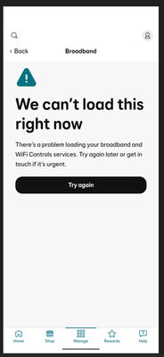

Hi Jim it has updated again overnight. It is now
R3.8.26-R-1595999-PROD-1 App Version is 3.1.3.19 24/12/2025
This version has broken manage broadband on the EE-App, it just hangs now as it attempts to load get this after a while.

The issue with the EE APP was caused by me changing the Admin Password via the Hub Manager webpage.
I had to do the following:
1) Clear the EE APP data
2) Reset the Admin password back to the original, via Hub Manager (The EE APP refused to accept my Admin Password)
3) Go though the set up and pairing process again on the EE APP using QR code (Which worked again as Admin password is embedded)
