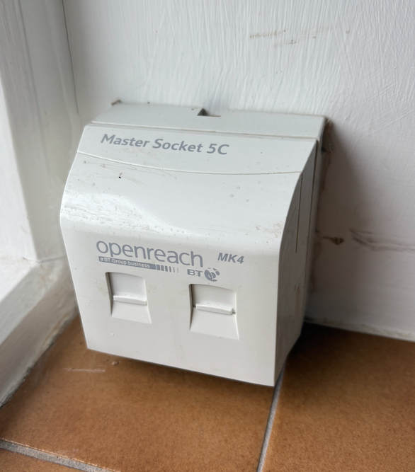

I'm moving into a new house next week at short notice and I'm looking for broadband options that are quick to set up (within a few days ideally) but I'm reading it typically takes weeks to sort out.
The house already has a BT Master Socket 5C (pictured below). I know EE uses BT infrastructure and was wondering if I'm able to buy a broadband package and router in-store and set up instantly myself? That's me assuming the long wait is typically waiting for an available appointment with an installer.

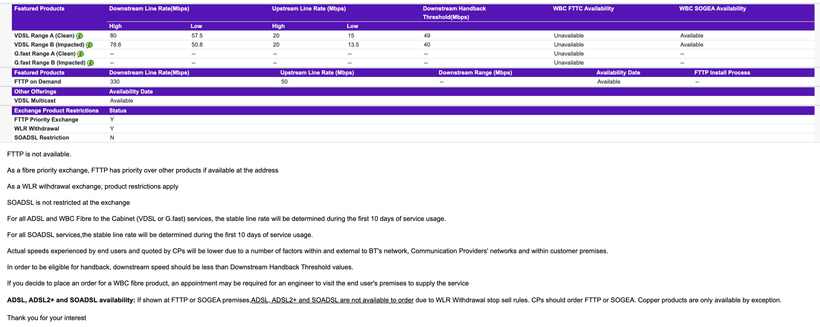

What does BT Wholesale Broadband Availability Checker > Address Checker estimate for your new addy? Post the whole table and the line above it, blanking out your phone number.

I've posted the table below.. We can't get amazing speeds with any provider as we're quite remote and only have part fibre connection available.
Thanks again for the response.

Thanks. That socket & the landline behind it is suitable for the only BB you can get from EE, up to 80 Meg partial Fibre FTTC (VDSL SoGEA) but it still would need activating by OR.
Ordering BB in a retail store wouldn't be any quicker as it still involves an OR visit which is the bottleneck. Also you don't walk away from the store with a router; it is supplied by EE as part of the order & installation. I wouldn't order from a store anyway as you get no statutory 14-day cooling-off period.

Just an update on this in case anyone else has a similar situation - sorted this via EE web chat whilst I was on hold waiting for assistance over the phone (just sent over the link to this thread for ease rather than re-explaining the situation + so they could see the socket):
I've been told that as we already have the BT OpenReach socket; we don't need an engineer to come out for the install - instead, all equipment will be shipped over for myself to install and will be activated remotely.
I've been given an activation date 7 days from ordering but have been told it could be activated sooner if the equipment arrives early. Couldn't definitely say that this is speedier but it's sooner than the estimated install dates provided online!
Thank you all for the advice - and if you have an existing socket still check with EE/BT that it will work.
on 19-07-2025 05:14 PM
An OR eng. may not need to visit your home but he will certainly need to attend to the installation at the local cab. and/or exchange on the installation date.
