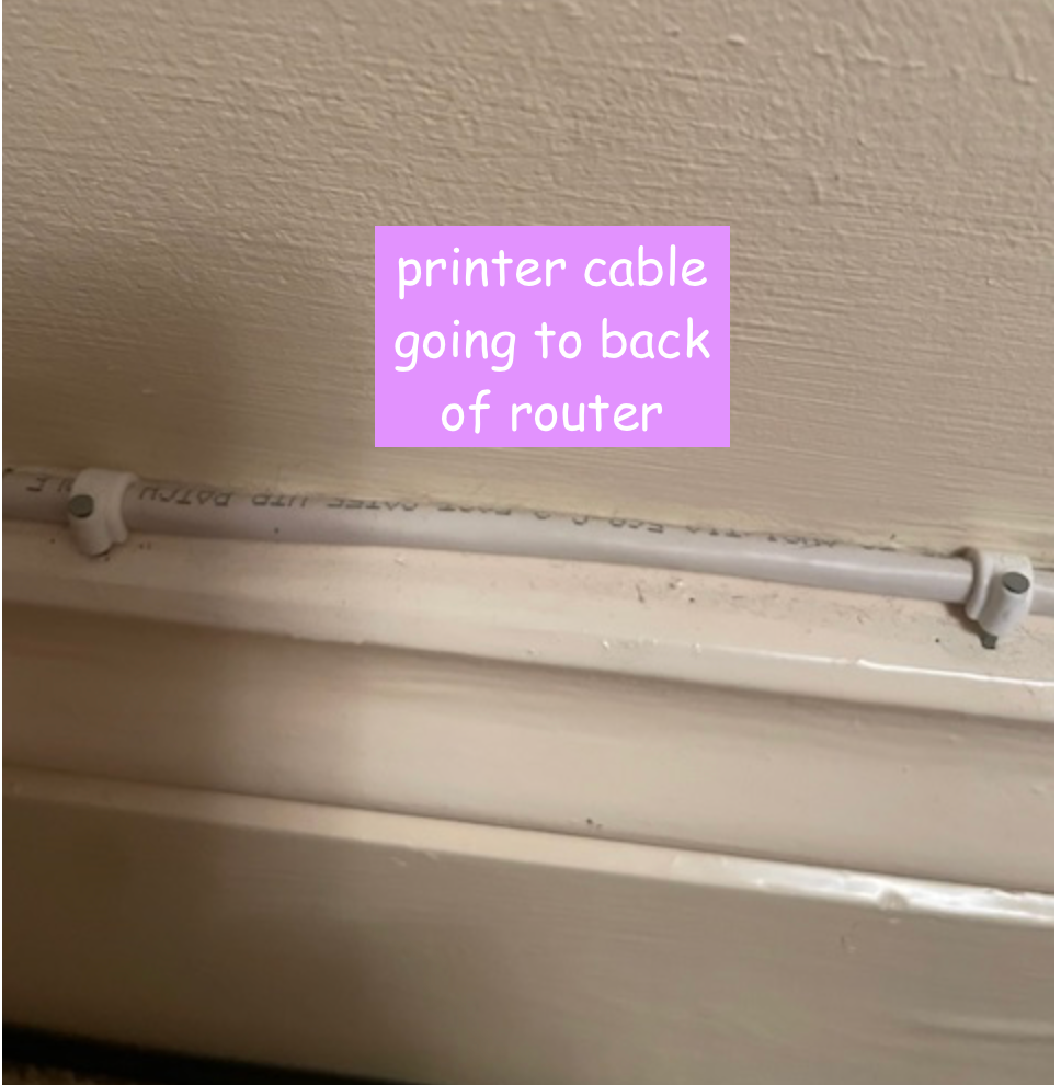

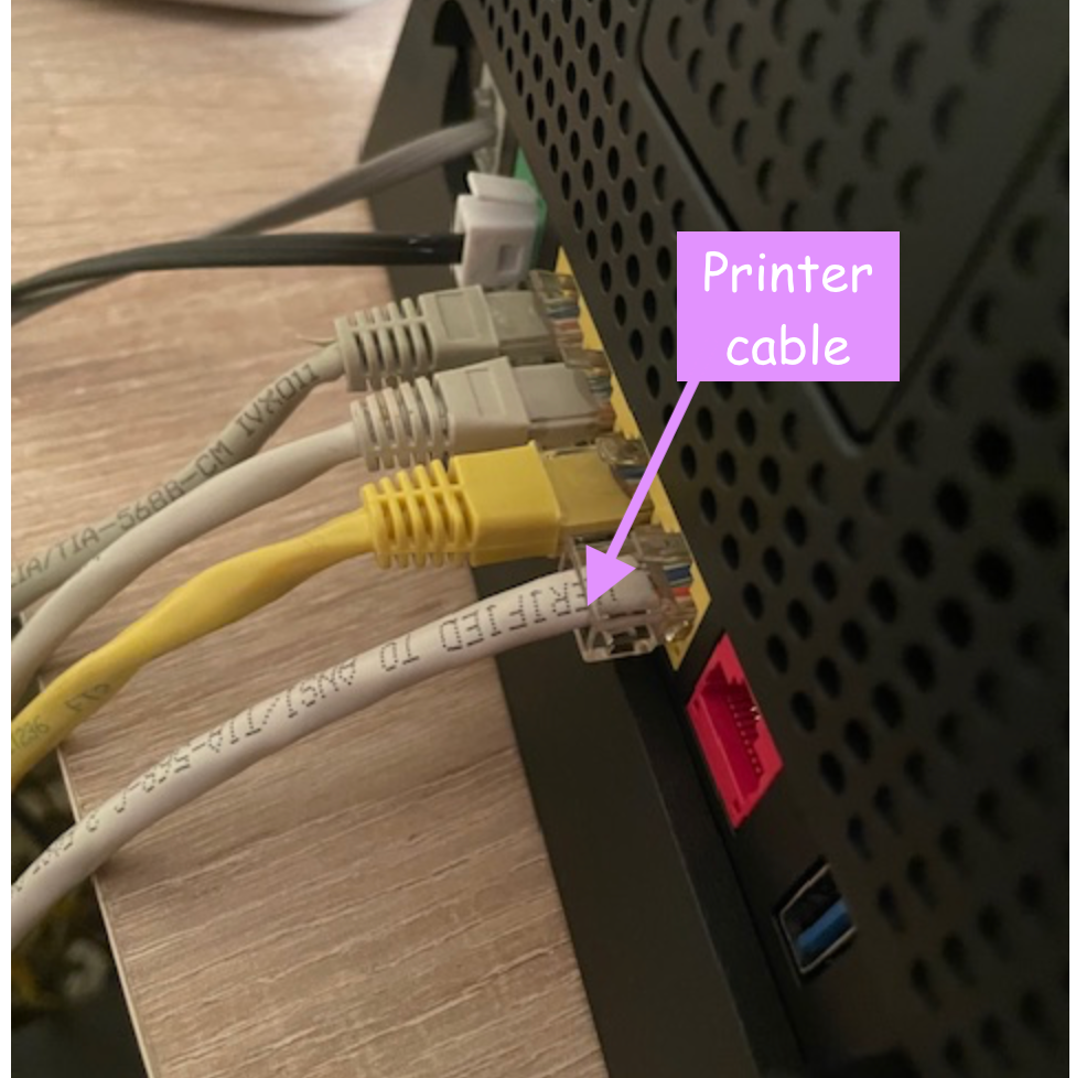

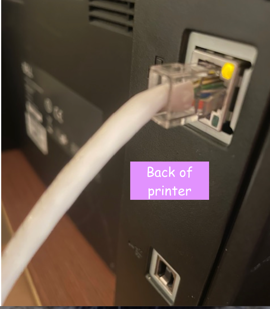

The netgear thing is an ethernet splitter, allows you to connect more devices.  The printer definitely has a network cable - (see photo's), I followed the wrong cable in a pic I took earlier, it is pinned to the skirting and actually goes straight into the back of my EE router.  Omg those photo's are enormous - sorry 😂

Sorry Jim, made a mistake, followed the wrong cable - the Dell printer cable is white and is pinned to the skirting board and goes straight into the back of the EE router NOT the splitter ...😂  no idea why these photo's are going in so big 🤗

@Ren77 Try the following but not sure if will work, on the back off the printer disconnect the Ethernet and plug it into a laptop if you have one if it connects which i think it will do then EE Router port is good, Port 4 where it is plugged into on the EE router is showing no connection but the printer with the yellow light on it is showing something, but would have liked to seen the green on also, no way to workout what the indication is as there is really no standard, Just think that the old dell does not like the new EE router port, there is a link earlier in the posting about getting a Tp-Link switch usb power cable for it and a patch cable unless you have one lying around.
The dell is old and got old port speed nic on it, the wireless function on the printer is also ancient as you will see from the spec sent earlier. Cannot get past your call guardian on the BT line! from 8am onwards. Jim
