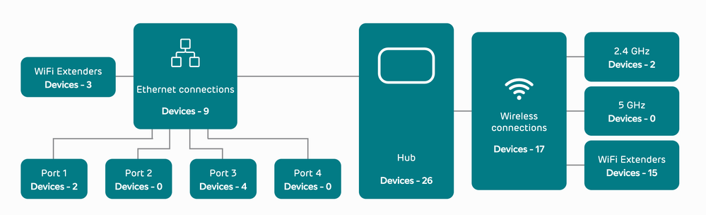

JimM11
Brilliant Contributor
@Ren77 Have a read at the link below with regards to the 20-30 second delay that the Ethernet port on that EE Router has, not saying it would be the problem and you would need to get a short patch cable also if you go that way unless you have a spare lying around, otherwise http://192.168.1.254 and web manager to the hub and see if you see the laser printer attached as an Ethernet device with a connected IP.

JimM11
@Ren77 See attached this will give you an idea for what to look at with the web manager.
EE Smarthub+ SH31BEE Smarthub+ SH31B

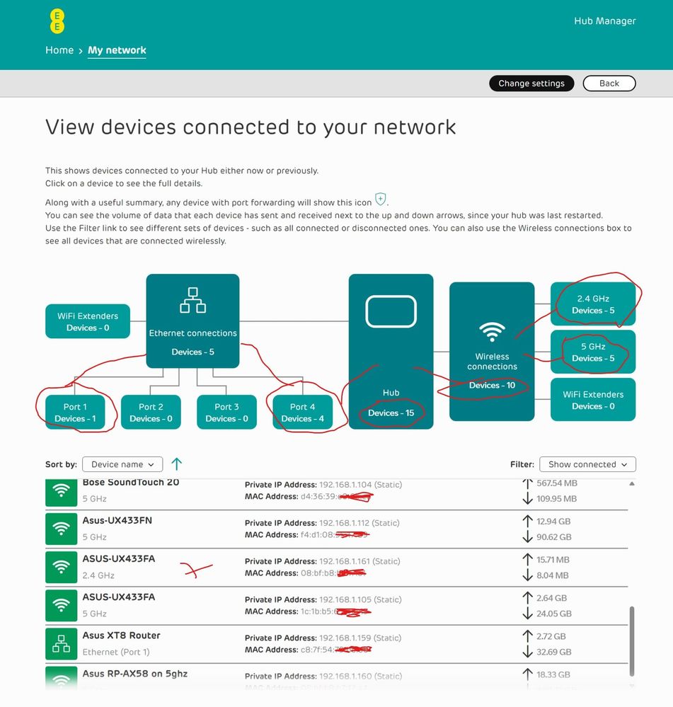

Ren77
Contributor
Contributor
Oh when I click on that link you gave me earlier this is what came up, it doesn't look anything like your screenshot, I'm probably not looking in the right place - I clicked on  http://192.168.1.254
[mod edit: image removed as contained personal details]
Ignore the above - found it (I'm an idiot) - will post images here and the connected list lower down, can't see the laser printer though (Dell).HUB MANAGER.png
